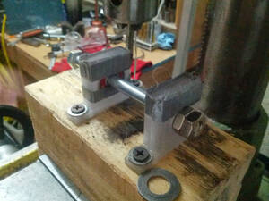

Next, we placed the bolt into the hobbing jig held in the mill's vice, and turned a 1/4“ tap against it to cut the teeth. We produced three (hopefully) usable bolts, one for an Ultimaker and two for the Tantillus.

  • Use M8 bolts if possible so they fit standard 608ZZ bearings. The 5/16 bolts were a bit loose.
  • We had some concern about the 3D printed jigs but they were very strong, printed in PET at 100% infill.
