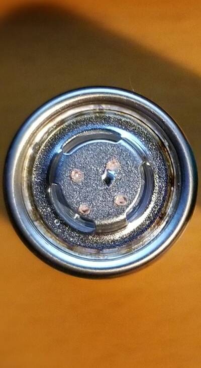

The 18650 cell positive terminal is an area of high risk for external short circuits due to the proximity between the negative and positive terminals. When working near the positive terminal keep in mind the following:
  • If possible, wrap any conductive tools with a non-conductive material such as electrical tape
  • Avoid applying pressure against the outer edge of the terminal

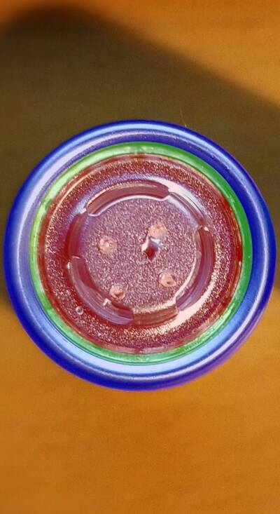

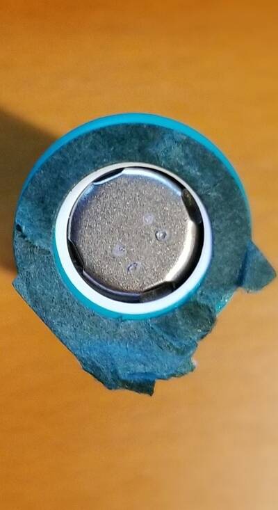

In this picture you can see that the distance between the negative and positive terminals of the cell is less than 2 mm
Red → positive terminal
Green → insulating plastic washer
Blue → negative terminal
The battery pack manufacturers include a layer of non-conducting cardboard between the cell and the inter-connecting strips

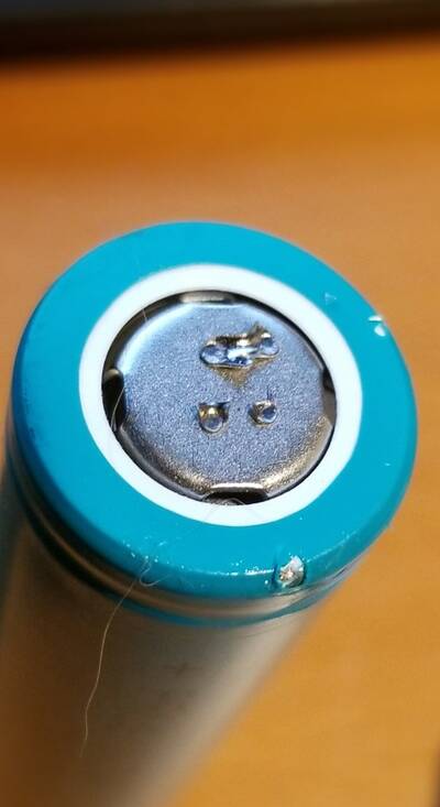

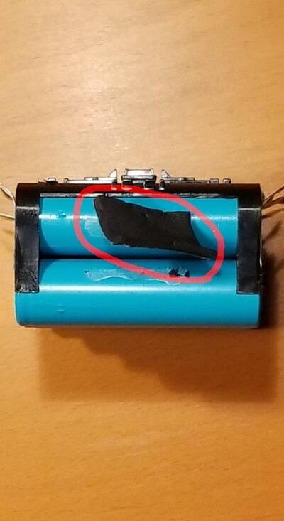

In the second picture you can see how a light amount of pressure caused a short circuit that melted some of the insulating plastic away. This could have welded the tool to the cell causing the short circuit to over-heat the cell and trigger a fire or explosion

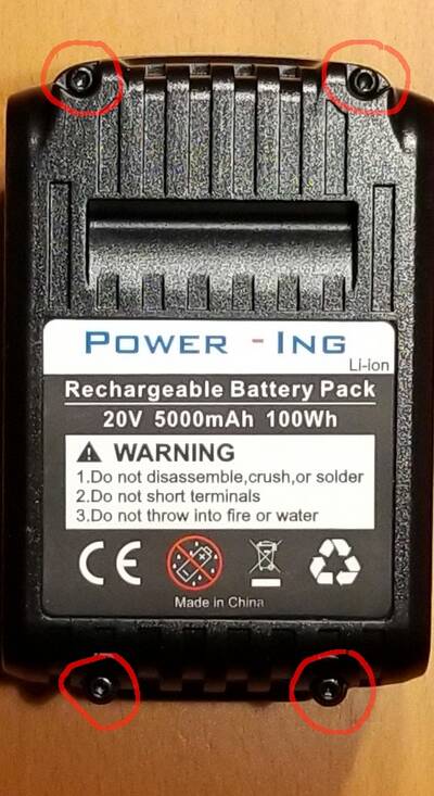

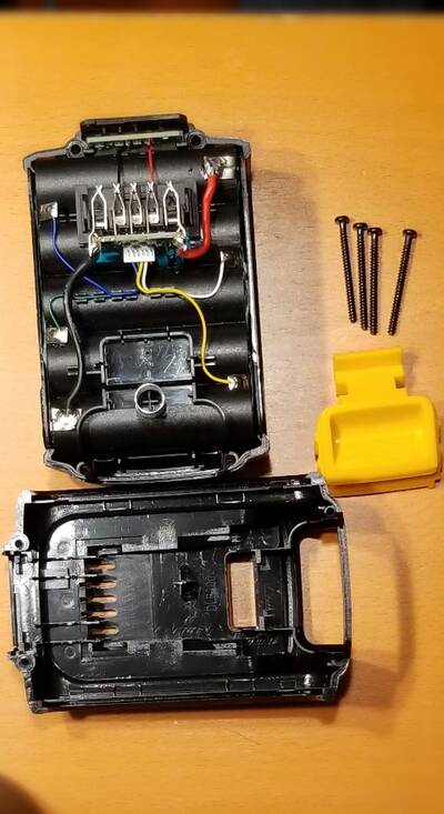

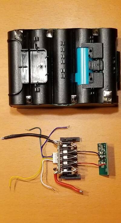

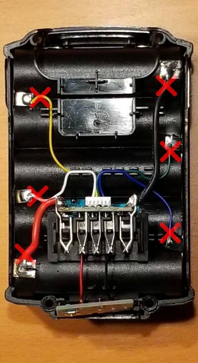

Using a #10 Torx screw driver remove four screws from bottom of battery pack and remove cover and spring
Cut six wires at the solder points marked with X, then lift and remove connector from battery pack
The connector has an easy to use, self-contained, battery level indicator

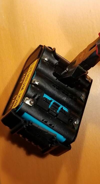

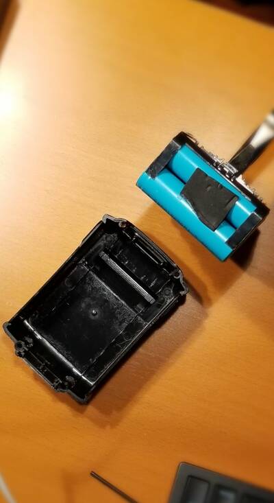

Using Lineman's pliers grab the battery carrier by the plastic ridge and pull it straight out of the battery case
Remove padding foam from end of battery pack

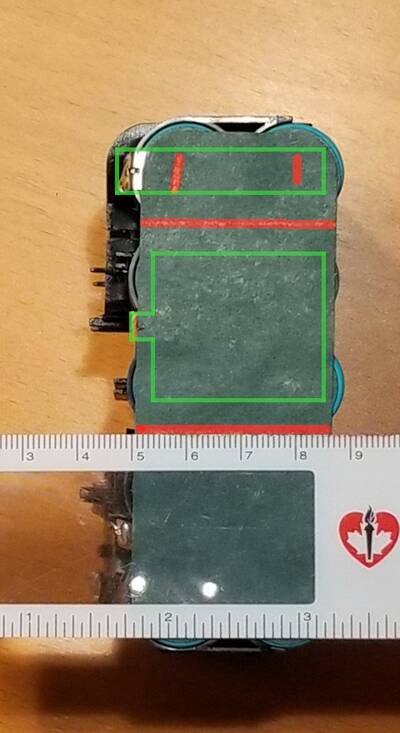

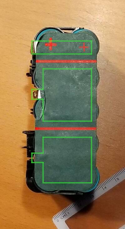

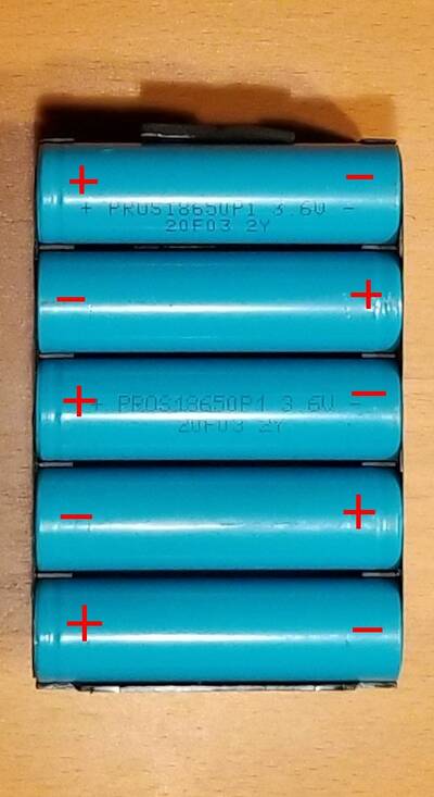

Note picture indicating cell terminal polarities
Using the picture above as reference, mark the red lines on both cardboard sides
Green lines are given for reference only and they represent the metal strip that interconnects the cells
The red lines are meant to indicate where there is no connection between the metal strips

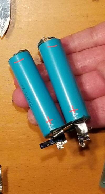

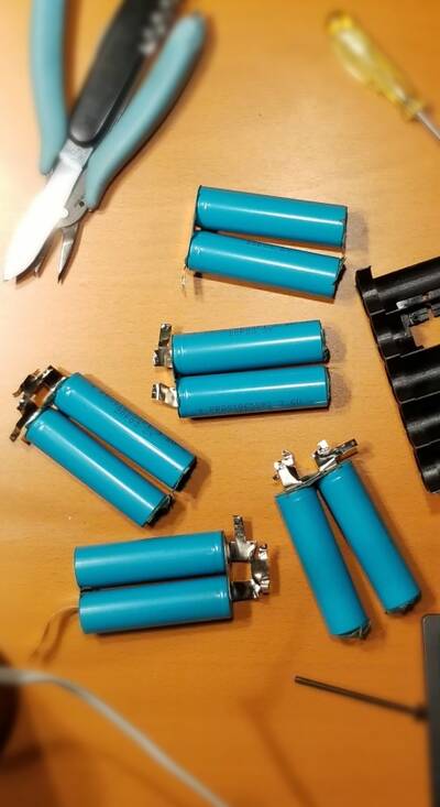

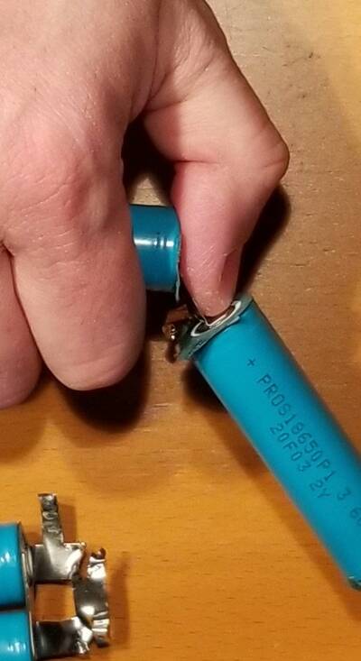

You will end up with five pairs of Lithium Ion cells that are still connected at the positive terminals
Due to the risk of short circuits when working near the positive terminals, for this step you will use your hands (preferably gloved to protect them from sharp edges on the metal strips)

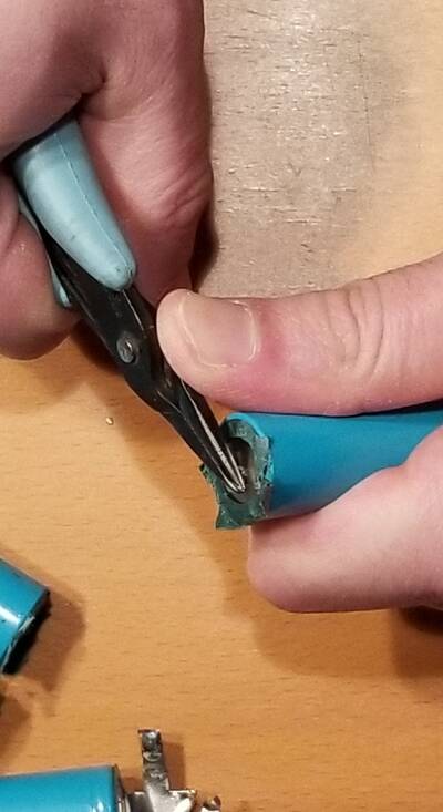

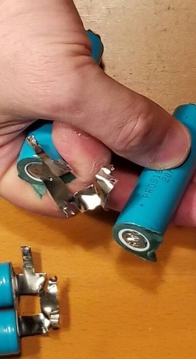

Using your thumbs as lever points, pull the cells away from the metal strips
Using the needle-nose pliers, grab onto any parts of the metal strip that are still attached to the cell and using your thumb as a lever point (Do not use the cell for leverage as you could damage the plastic insulation and cause a short-circuit) pull the remaining metal away from the cells

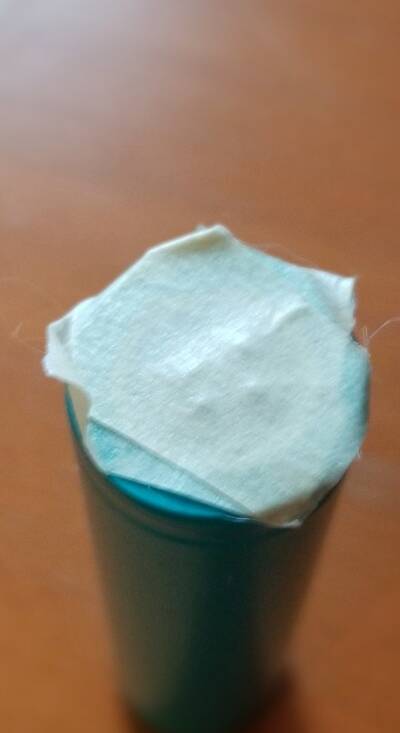

Once done, cover the positive terminal with some tape to prevent accidental short circuits
