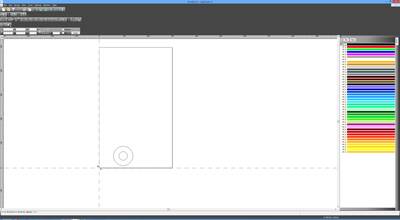

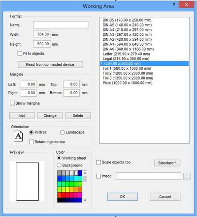

Once you've imported your file according to the steps above,the first thing you'll want to do is to set up your Working Area to understand how your artwork fits on your material.
1.Working Area To do this go to Settings > Working Area on the top menu panel.Once in the pop-out window you can adjust the width and height of the Working area to the required size.

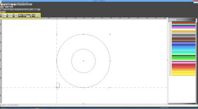

2.Resizing Generally you might need to resize and reposition your artwork. You can do this in the parameters window, see image below.

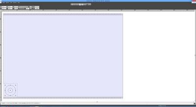

3.Artwork positioning The actual position of your artwork relative to the working area doesn't have any bearing on the final output as the software relocates your artwork to the zero point before outputting. You can check the final position of your artwork in the Preview tool. This is a representation of what will be cut. File>Output>Preview

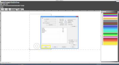

4.Output Once you're happy with how the preview looks you're almost ready to get cutting. First you need to check some of the parameters. File>Output.
-Pressure - I recommend 250-275 (thicker material may need more). Nich's Update: I tested with 250 and cut right through, and found that for the material I found in the scraps bin, 75 was about right, though there was a small bit of bunching on tight corners.
-Speed - 5cm/s (slow down further if you have intricate cuts)
-Material - Width & Length, this is important as if you don't set it large enough, the program will cute up some of your design thinking you need to add a new material roll.
-Weed Box - this will cut an offset box around your artwork, depends on whether you want to save material or not.
