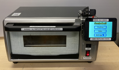

VHS now has a SMD Reflow Oven that is sitting in the soldering section (looking like a mild mannered toaster oven)…
The oven is based the design found here: https://www.whizoo.com/reflowoven
It has recently been upgraded to a new ControLeo3 touch screen controller (https://www.whizoo.com/) that features a touch screen and allows for multiple profiles. This lets you store different profiles for using different types of solder.
While I didn't document the build of this oven, it is very similar to the one I originally built for myself and you can find the Instructable for it right here: https://www.instructables.com/Making-A-SMD-Reflow-Oven/
While you are at it you should also check out my Instructable for setting up a solder paste dispenser: https://www.instructables.com/How-to-set-up-repair-adjust-and-use-a-solder-paste/ We don't have one at the Space (yet) but it has some basic info on SMD soldering using the oven
The oven currently has two profiles configured (#1 - Lead free paste 250C or Leaded Paste 225C). The oven can have 28 different profiles added using the SD card. Refer to this page for information on creating more: https://www.whizoo.com/profiles

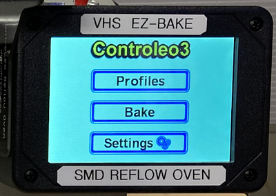

2) The LCD touch screen should show this (if not then hit the HOME icon on the bottom of the screen).
3) To start baking your PCB select the Profiles button.
4) Confirm you have the correct profile set (if not then hit the Choose Profile button and use the green arrows to select the desired profile, then use the Back Arrow to return to the above menu).

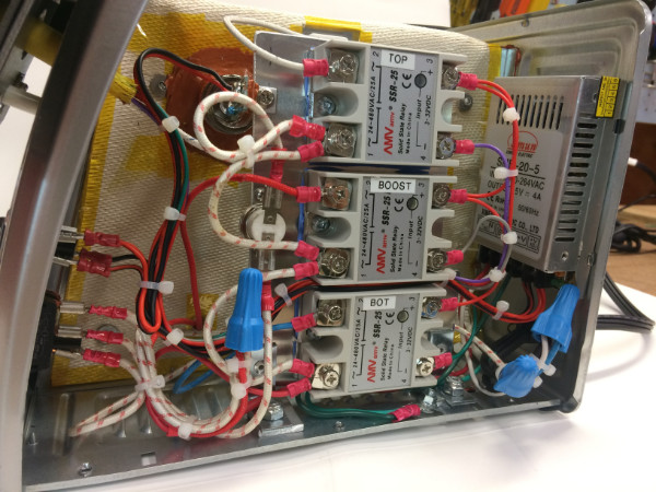

Inside Wiring:

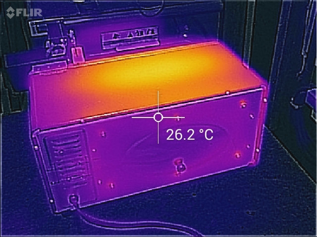

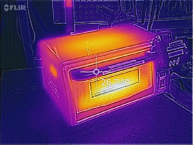

Some IR Views Showing Heat Dissipation (cuz I had access to a FLIR camera)… Front:
Back:
