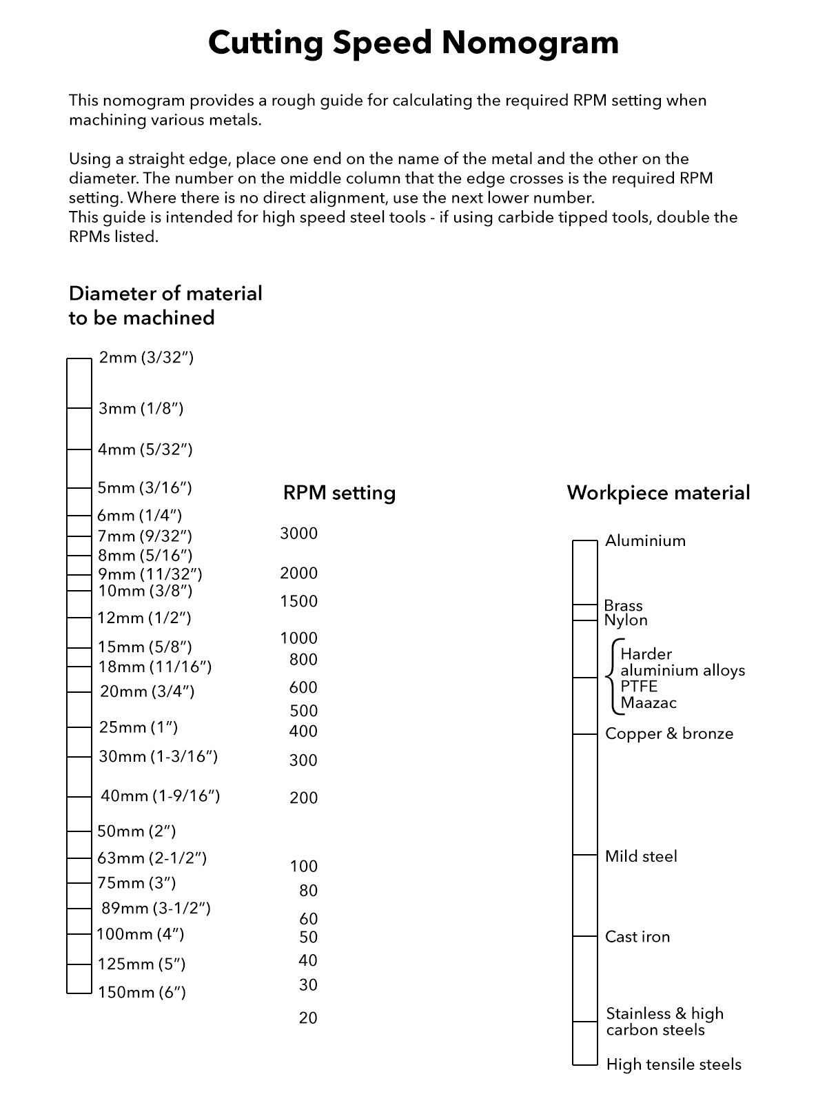

Cutting Speeds
Cutting speeds can be determined easily by using this cutting speed nomogram. The original cutting speed nomogram came from Ian at the BCSME.
When getting into hardened, tempered, or annealed steels along with carbide (necessary) cutters, cutting speeds and depths can be unpredictable when going for a high-quality finish, and experimentation may be required. The video The Effects of Heat Treatment on CrMo 4140 Steel in Turning Operations Part 2 is a great example of this, but do note that the video is from a much larger and more rigid lathe than ours! Part 1 has some good background information at the beginning, but Part 2 usurps its results.
