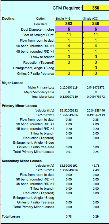

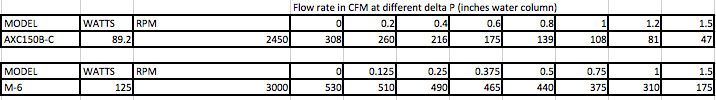

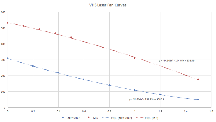

For an 80W CO2 laser such as that of VHS, the suggested minimum flow rate is 250cfm. In order to meet these requirements, a target setpoint of 350cfm was used. To meet this spec, two axial fans original designed for hydroponic applications were investigated. The fan curves are below:
Given the 6' ducting, and required filters, the major and minor Dp's were calculated and compared to the available fan curves. This determined that the optimum setup was a single M6 fan with minimal other backpressure as seen below:

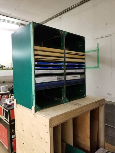

Filter Setup
In most cases, a prefilter, bagfilter, HEPA filter is the preferred option. This provides the longest lasting filter media for this application of the systems reviewed. However VHS has a modular setup that is arranged to accept standard 20“x25” furnace filters. Therefore the arrangement above was created using:
  1. 2x reusable/washable plastic prefilters to capture large particles entrained in the flow from the laster
  2. 4x Filtrete 1900 MPR 1900 “Maximum Allergen Filtrete Furnace Filters” (Can be replaced by a single deep pleat MERV 14 or higher commercial filter as necessary).
  3. 6x trays of 1“ Jacobi Ecosorb GXB Activated Carbon (or equivilant)
This system is designed to: a) reduce particulate entrapment in the fine particulate phase, b) ensure removal of particulate matter which is roughly similar to tobacco smoke as per literature on laser exhaust, and c) have sufficient residence time of the air in the carbon bed, while not increasing the overall dP of the filter system.
According to literature from the EPA (Download PDF) it is suggested to use a minimum bed depth of 3”, along with face velocities of between 50-100 fpm to reduce streaming and breakthrough, while providing sufficient residence time. It should be noted that in this setup, the number of trays and flow area has been maximized in order to lower dP, and increase residence time. At the specified 350 cfm, and the 1/2 filter box area currently in use, the residence time in the current design is approximately 0.3s.

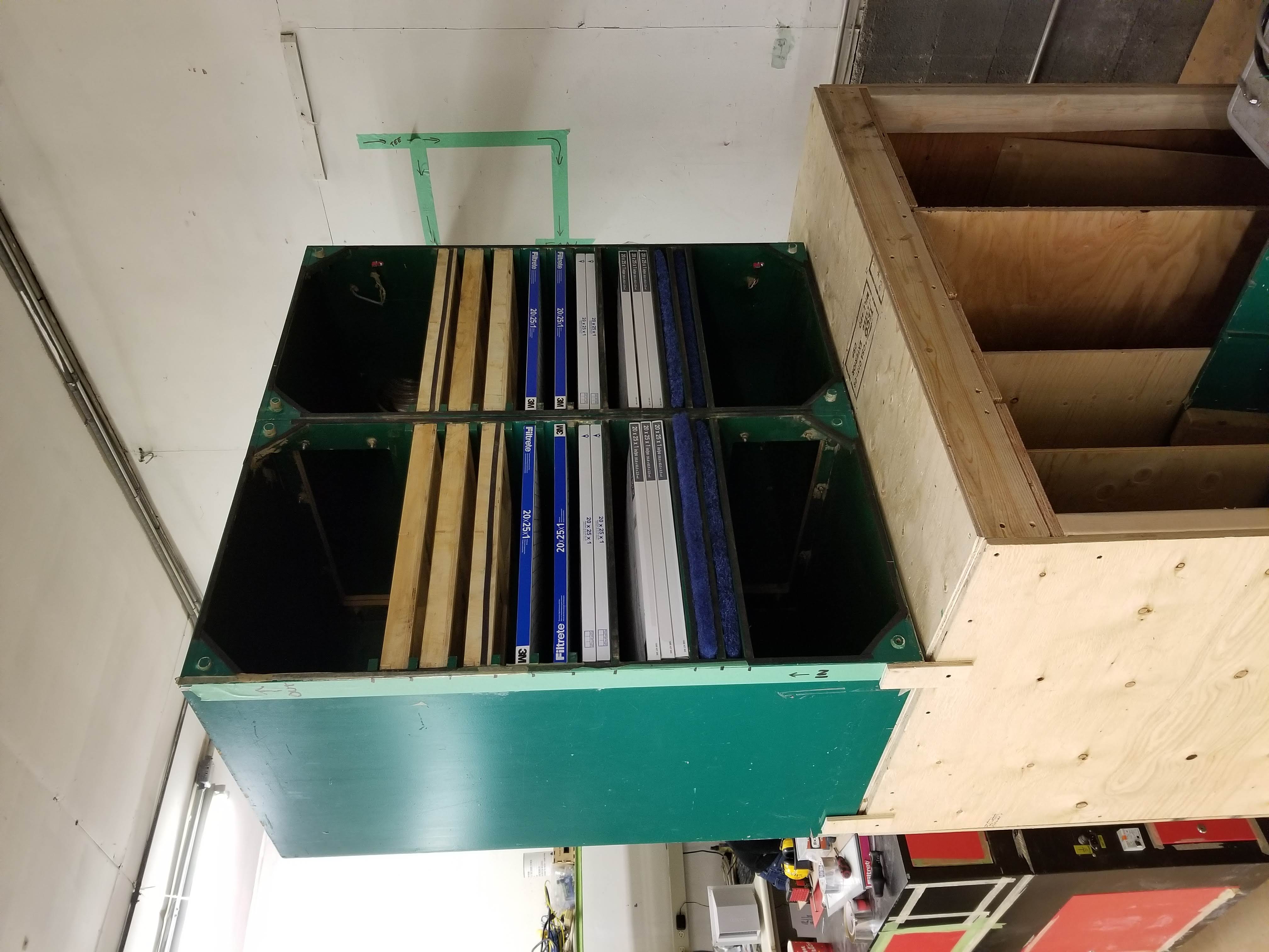

The current filter setup is shown below:

The air in the filter stack moves from bottom to top. All filter elements have an arrow indicating the direction of airflow. When installed correctly, the text on the filter elements will be upside down, as seen in the picture above. Always rely on the direction of the arrow. There are three different types of filter elements, each with different characteristics. It is imperative that they are installed in the correct order. In the current configuration, only L2 filters (the dark blue filters without a paper frame) are washable. If a filter element is replaced, please label it with a date.
