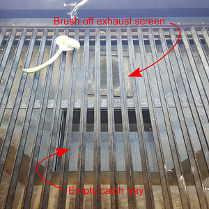

  • Clear the top, bed, and catchment tray of material.

  • Clear the laser cutter's top, bed, and catchment tray of any material.

  • Clean out the catchment tray
  • If necessary, clean accumulated dust of the exhaust mesh using the dish scrubber brush

  • Clean the mesh screen in the bottom of the laser cutter with a dish brush
