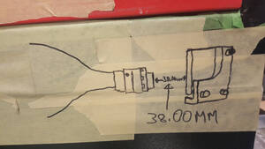

The new tube was carefully unpackaged and then installed. The horizontal distance from the exit mirror to the first mirror was maintained at 38 mm.
Tube installation instructions

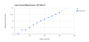

Current Measurement
A test pattern was created with 12 parallel lines, 80 mm long. Each line was set to a speed of 20 mm/s and increasing power levels from 5% to 60% in 5% increments. The cut was initiated and the current was recorded by hand from the current meter. The laser cutter file was saved in the Laser stuff folder.

After further testing, the minimum power level to initiate lasing was 6.7%.

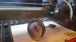

Power Measurement
The power meter was prepared by using the included wrench to set the power to zero using the nut on the rear of the gauge. The focus lens was removed from the laser assembly and the power meter mass was positioned under the unfocused beam. The laser was set to a power of 60% and manually fired for a total of 21 seconds using a stopwatch.
After waiting approximately 25 seconds, the laser power meter read about 78 W.
