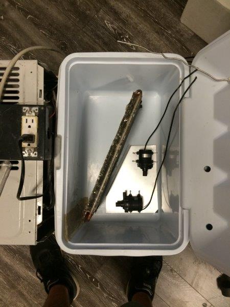

An AC unit water chiller was fabricated to replace the CW-3000 and provide consistent water temperatures year round. The AC unit was a 5000 BTU (1800W cooling power) air conditioner purchased on craigslist for $20. The evaporator (cold) side of the AC unit was relocated to the interior of an insulated chest cooler and the holes made in the cooler were sealed with expanding foam and silicone sealant. A temperature controller was then installed to turn the AC unit on / off based on the water temperature in the cooler. The water in the chest cooler is then pumped through the laser cutter tube using a submersible pump. A second submersible pump keeps the water moving in the chest cooler (it could be argued that this pump is not needed, but in times of heavy use, this keeps the evaporator coil from icing up)

The pumps used were replacement water pumps for the original CW-3000 chiller. This ensures we have the same flow rate as the laser cutter was designed for. http://www.rabbitlaserusa.com/WebShop/Chillers.html

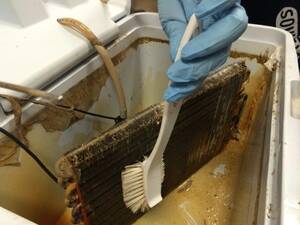

The chiller was rebuilt after 10 months service and was re-sealed. PL Premium polyurethane adhesive was used to seal the slot cut into the cooler in January 2017. Time will tell how long this seal lasts. CLR was used to scrub the evaporator and was flushed through the laser tube for a few hours to clean out the lines.
Chiller after 10 months service (no or limited anti-microbial / antrifreeze used)
Resealed and cleaned
