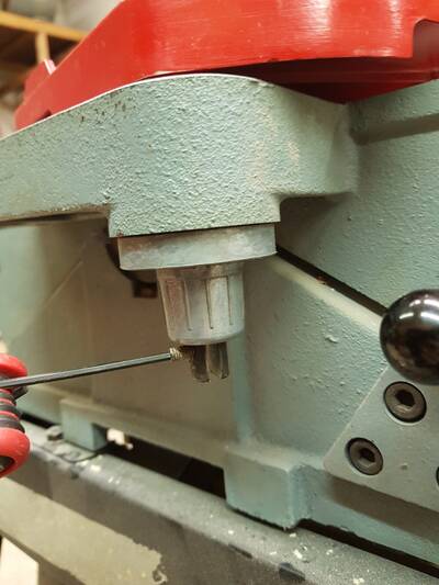

Step 1. Remove the safety guard On the Delta 37-190C usually one can just pull the safety guard right out of its holder. Ours has had the shaft of the guard modified to have a stopper bolt installed to prevent the guard from accidentally being removed. Use the hex wrench to remove this bolt. The whole safety guard should slide right out.

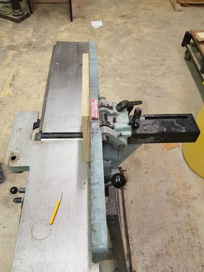

Step 5: Measure the straight edge of a piece of plywood with a 1/4“ marking. Position it so that the marking is against the outfeed table's inner edge.
Step 6: With the fence all the way at the back, rotate the drum in the normal direction of travel. The blade should slightly catch the plywood and move it forward. The intention here is to make it move forward only 1/4”. If the plywood does not catch, raise the blade using a hex key on the riser bolt. I found it easiest to get it close to the point where it will catch, then turn the bolt very slightly (1/8 of a turn or so). Keep going until the plywood moves 1/4“. Repeat with the fence all the way at the front.
Once you are happy with where it is, tighten the jack screws. Check again with the plywood to make sure the blade didn't shift while you tightened (it usually does, it can help to hold the blade down with the ends of your fingers on the bevel).
