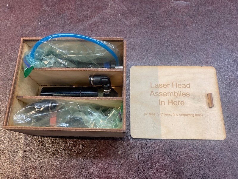

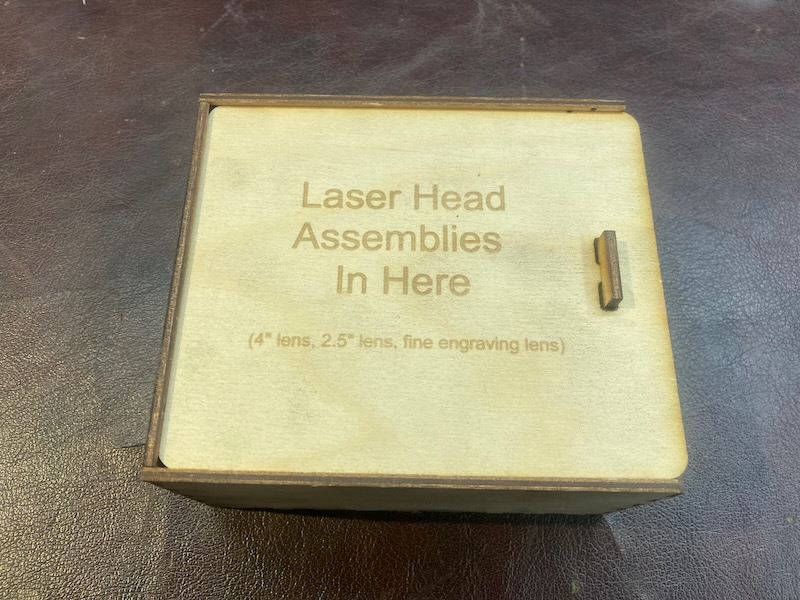

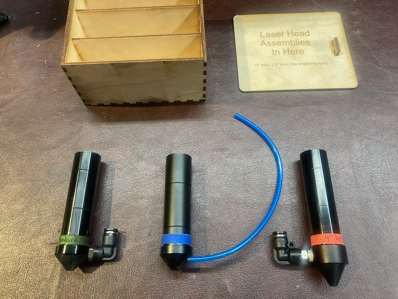

VHS currently has three laser lenses that live in a storage box on the shelf on the laser bench.
The Three Laser Lens Types
  1. one 2.5 inch (standard) lens. (green tape)
  2. one 4 inch lens. (orange tape)
  3. one compound engraving lens. (blue tape)
2.5 inch Standard lens (green tape)
This is the lens that any user should find on the laser cutter when starting their session. The usual power, speed settings and focus guides work as expected with the standard lens. All trained laser users should have no issues with using the standard lens as they normally have.
4 inch lens (orange tape)
This lens is used for cutting thick materials from ⅜” up to ¾” plywood/softwood and perhaps up to ½” hardwood or engraving into deep recessed pockets.

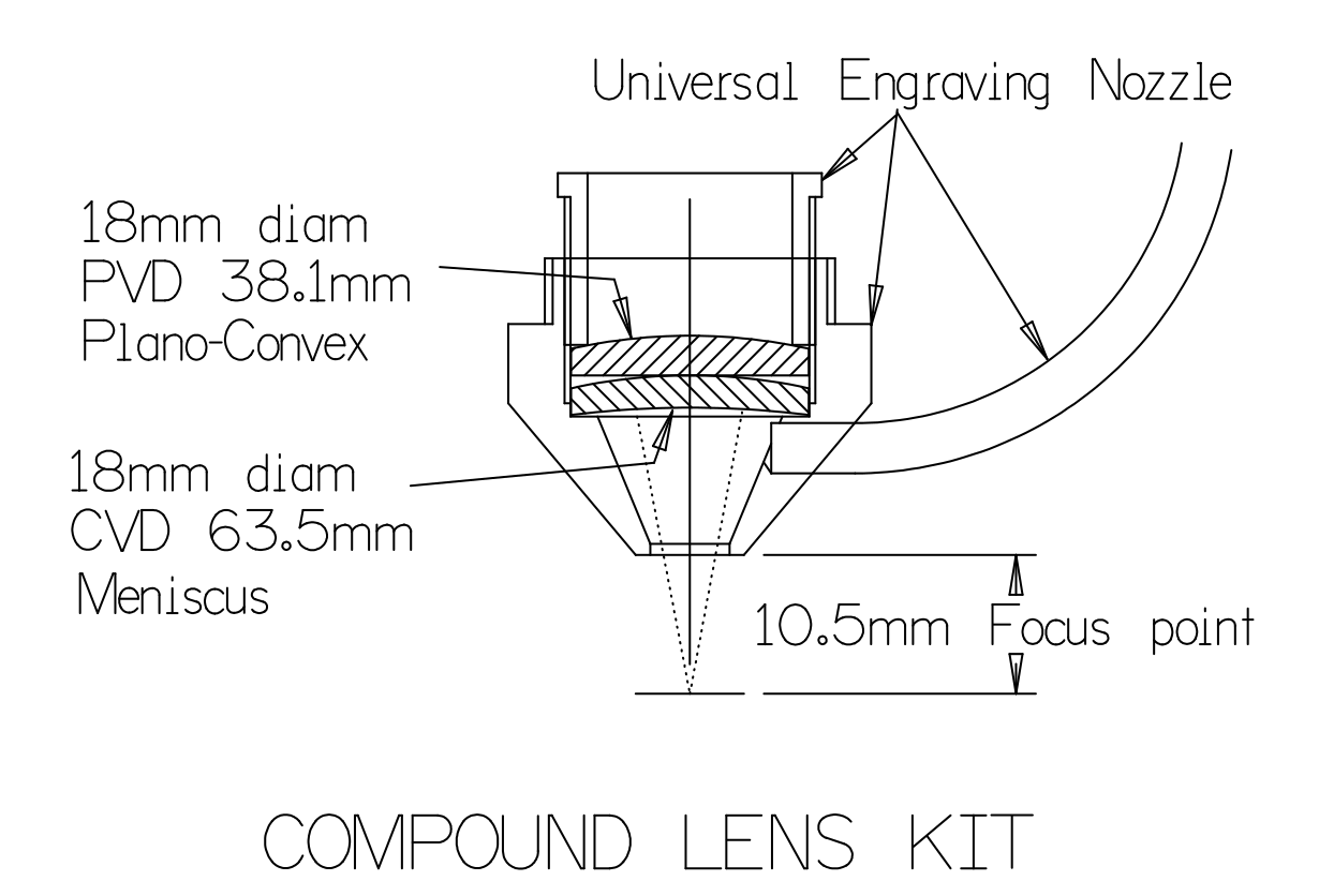

Compound engraving lens (blue tape)
This lens is used for fine detail photo engraving. This lens when properly focused and using proper speed and power settings should be capable of producing 0.1mm dots.

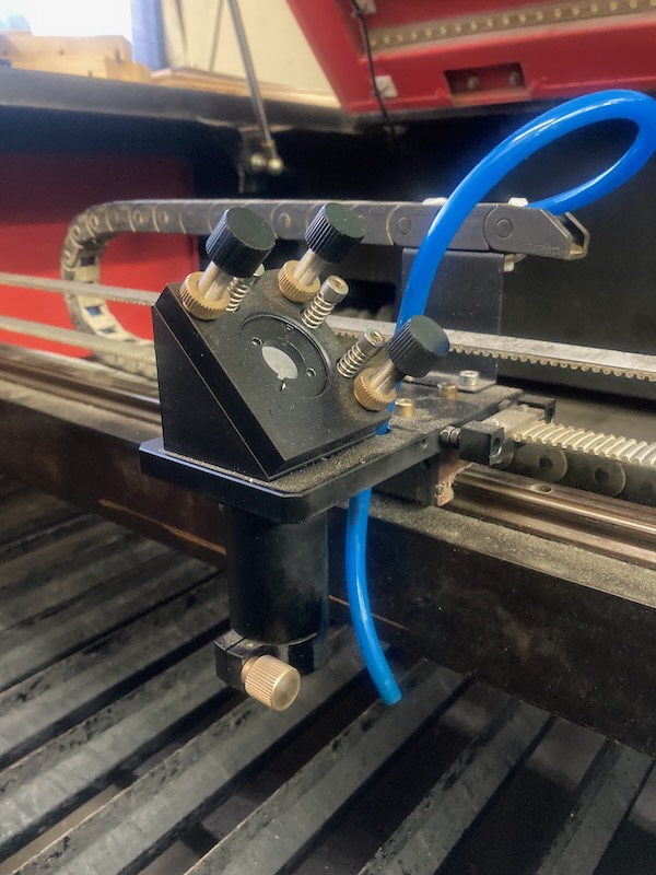

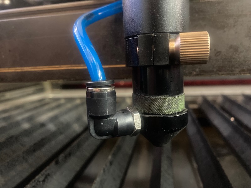

Lenses are installed in the head assembly by sliding them into the lower tube and securing by snuggly tightening the lower knob and then attaching the blue air assist tube to the lens. Below is that head assembly and air assist tube without a lens installed.

  1. Slide the lens into the head assembly and gently snug the knurled knob. Do not over-tighten.
  2. Attach the air assist line to the lens

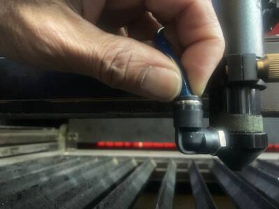

Detaching and attaching the air assist.
The standard and 4 inch lens have a simple push to insert and push to detach system while the engraving lens has a small diameter tube that is inserted inside of the air assist line.

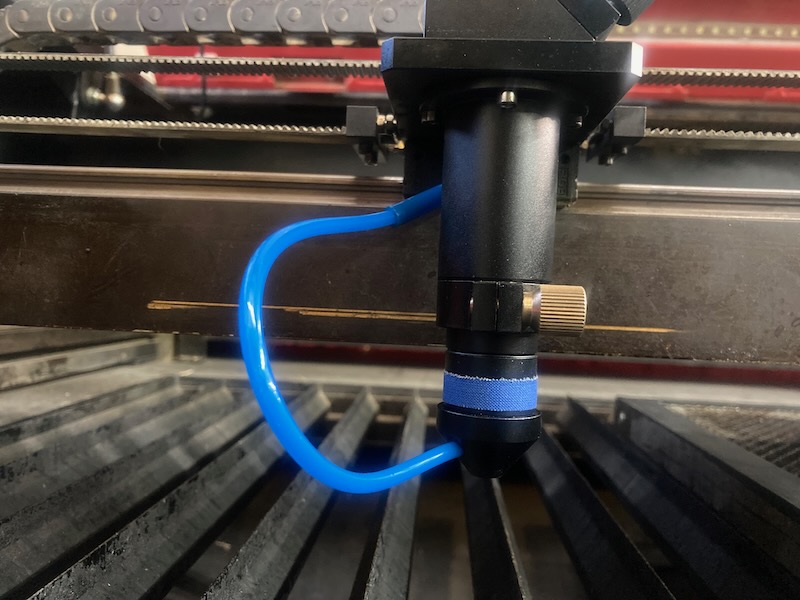

Laser lens with blue air assist tube attached
Push down on outer ring to release and gently pull the blue air assist tube from lens

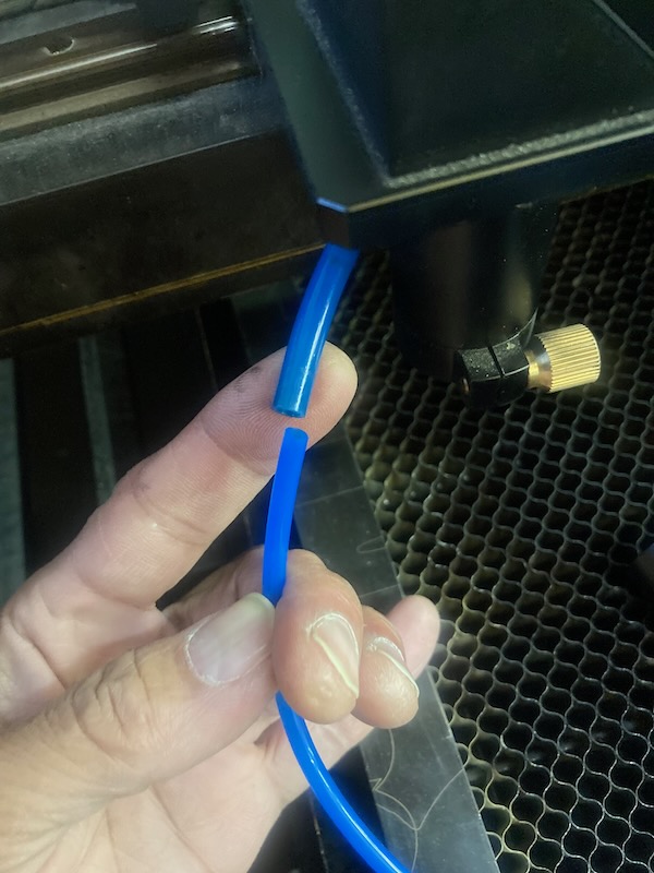

The laser engraving lens has a smaller diameter tube that is permanently attached to the lens. Just slide this inside the larger diameter air assist hose.
Smaller diameter air assist hose inside of larger diameter air assist hose.

This compound lens was designed by YouTuber RDWorks. They have a very nice video outlining in depth information about engraving using this compound lens. https://youtu.be/ZG5KsMw8fJY?si=mj3bWv7gRNXFy1x2
The current documentation calls for 10.5mm focus height but testing at VHS shows 11mm works better.

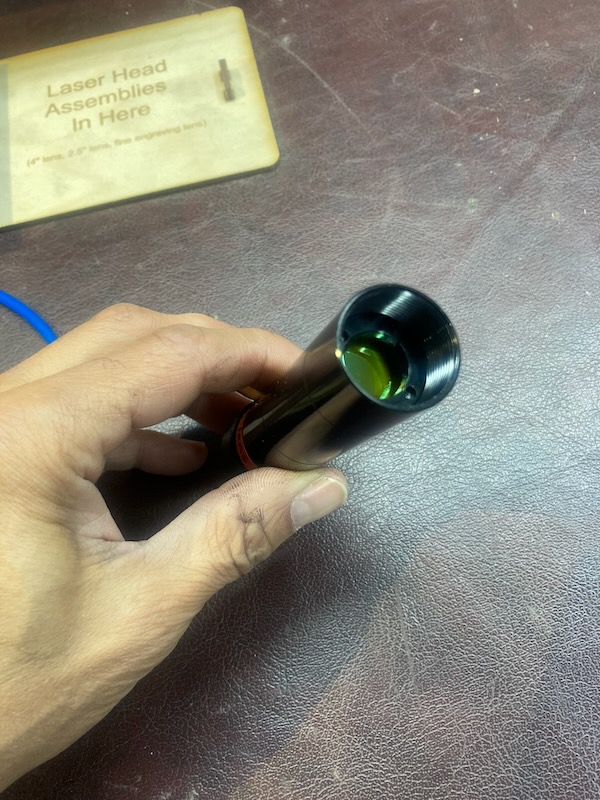

  1. Inspect the laser lens by looking through the end of the tube. If the lens appears dirty then please alert the Laser Cutter Committee so that they may perform laser lens maintenance. Do not use a dirty lens as this will cause dirt to be baked onto the lens and permanently damage it.
  2. Ensure that the 2.5 inch standard(green tape) lens is left on the laser cutter for the next person. Return the 4 inch (orange tape) or compound engraving lens (blue tape) to the lens storage box.
Look through lens to see if it is dirty and report to LCC.

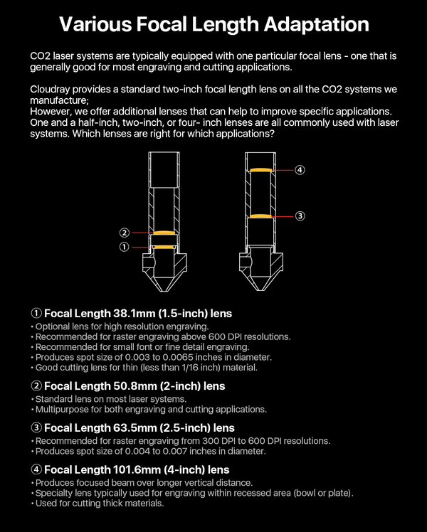

These lenses were purchased from Cloudray Laser
Compound Engraving Lens (blue tape)
The 2.5 inch standard lens (green tape) uses position 3 and the 4 inch lens (orange) tape uses position 4 in the following Focal Length Adaptation diagram.
