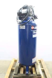

Air Compressor
Make & Model Campbell Hausfeld VT627505AJ
