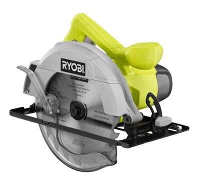

RYOBI 13-Amp 7-1/4-inch Circular Saw
Circular saw for cutting wood and not metal
Status Working as of Febuary 2020
Training Required
Owner Gabriel de Vries
If it Breaks Unplug machine, put a “broken” sign on machine, contact Gabriel.
Loan Status Loaned
Arrival Date January 2020
Location Woodworking Area
Value $
Do:
  • Wear personal protective equipment, including safety glasses or goggles, faceshields, and hearing protection.
  • Ensure all safety guards are in good working order before starting work.
  • Ensure the saw’s blade is sharp. Sharp blades are safer and work better.
  • Keep cords away from the cutting area.
  • Know that circular saws are designed to be used by right-handed operators. If you are left-handed, the saw will require more care to use safely.
  • Check to be sure the retracting lower blade guard returns to its starting position before laying down the saw.
  • De-energize your saw before changing or adjusting its blade.
  • Keep the saw clean.
  • Maintain good footing when using the saw.
Don’t:
  • Put your hand under the saw’s guard.
  • Operate a vibrating saw.
  • Force the saw when cutting.
  • Hold or carry the saw with your finger on the trigger switch.
  • Use the saw without first checking for materials, such as a nail or screw, that may cause an obstruction.
  • 13 amp motor for cutting various types of lumber
  • Bevel adjustment from 0° to 51.5° with positive stops at 45° and 51.5°
  • Speed: 5000 r/minute (RPM)
  • Depth of cut: 2 7/16 inches at 0°; 1 7/8 inches at 45° 1 11/16 inches at 51.5°
  • Air diverter and dust exhaust keep the line of cut clear while directing particles away from the user
  • On-board wrench storage for added convenience
  • Spindle blade lock for easy, keyless, blade changes
  • Includes: 7-1/4 -inch Blade and Blade Wrench
