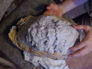

Results
  • We concentrated on getting good depth and we used a swimming cap. We got great depth and decided to do the ears, but the ears were totally unnecessary and rose way above the usable depth. Next time concentrate on getting more of the forehead and less of the ears.
  • We used straws in the nose and that worked fairly well. Though it left two small very round holes. I think rolled paper might work better as it'll better conform to the shape of the nose.
  • A few bubbles on the face, but those can be fixed up.
  • I'm concerned that the Ultracal isn't giving enough fine detail. It should be performing better, but it seems like a thin outer layer sloughs off when you demold. Perhaps we should try plaster next time. I've also heard good things about Hydrostone, so maybe we should try that.

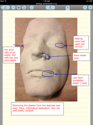

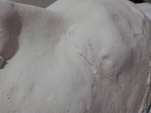

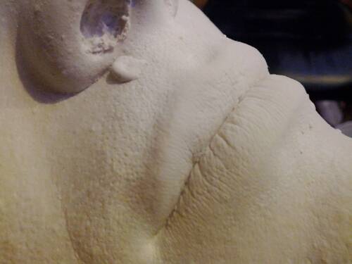

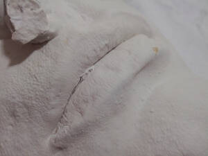

Amounts
  • Alji-safe Acrobat: 2.5 cups. About right. Could even do just 2 cups. Seemed too lumpy. Needs mechanical mixing.
  • Hydrostone: 4 cups, measured water very accurately. Was a good amount, but could have gone even deeper. 6 cups would get lots more depth.

  • We used a swimming cap, and marked a straight line on the head with tape to make we didn't go too high in parts and too low in others. We didn't do the ears.
  • We used paper tubes in the nose and that worked fairly well. But when we cast the head we forgot to plug the nose resulting in plaster protrusions.
  • A few bubbles on the face in the eye socket area where it meets the nose. Next time try scooping that area. Also try wetting the face first.
  • Hydrostone worked awesomely.
  • I checked the docs a bit more. Smooth-on recommends using a Jiffy Mixer or Turbine Mixer attachment on a drill to get a smooth product with Acrobat. I’ll pick one up this weekend. I think ICI Paints has them.
  • We should make sure in the future to apply a light coat to the eyes and scoop out any air bubbles before adding more.

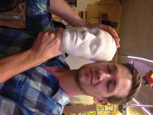

  • Alji-safe Acrobat: 2.5 cups. Perfect.
  • Hydrostone: 5 cups (2750g), measured appropriate water very accurately. Perfect.
Results
  • Near perfection. Perfect detail. Only a few air bubbles in the chin area, where facial hair stubble probably trapped some air. Next time make sure to smooth down stubbly areas.
  • Smoothing out the eyes worked perfectly.
  • Seems like an initial thinner layer of alginate over the face works well to reduce slumping, remove bubbles, and preserve detail.
  • Nose holes plugged with alginate. Worked well.
  • Hydrostone one again worked awesomely.
